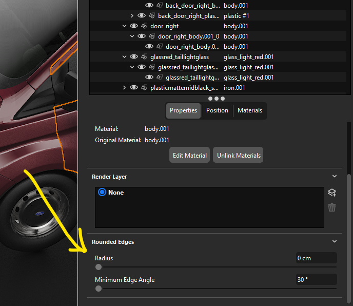

Thanks for the feedback, Oscar! I really appreciate it. Could you point me in the direction of where I can find the corner radius setting? I’d love to try adding it to the parts you mentioned.
https://manuals.keyshot.com/keyshot2024/manual/rounded-edges.html
You just select the part in the scene tree and you can enter a number at the properties panel. I saw a lot of your parts already had the edges modelled but it’s always really obvious if some don’t since infinite sharp corners won’t reflect any light.
And it’s basically a ‘fake’ round corner but works perfect for smaller parts and saves you all energy/time to actually model them which also makes the model more complex than needed.

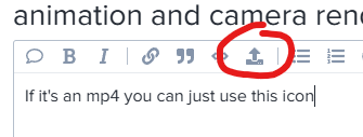

How do you upload videos in posts? So I can send it not as a link. This is my first day on your wonderful forum.
